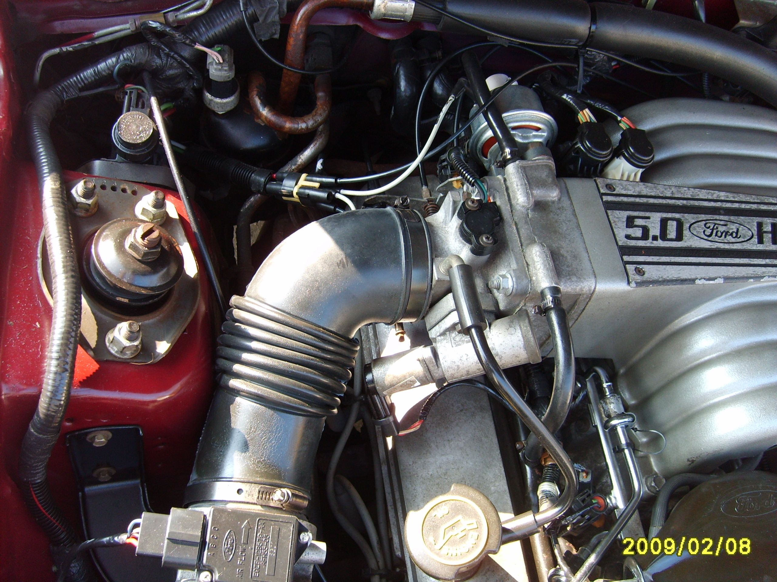

I had the hood up with the engine running a few days when I was chasing down other problems when I heard suction sounds coming from that small hose that plugs into the oil filler tube on the right valve cover just below the oil filler cap. It ends up going into the throllel body right before the AIC motor. I put a small clamp at each end and it ended that small noticable sound from irritating me....This picture was taking before I added the hose clamps but the ends are larger then the hose but were hard as rock and loosing any type of seal around the tube they were plugged in to..
