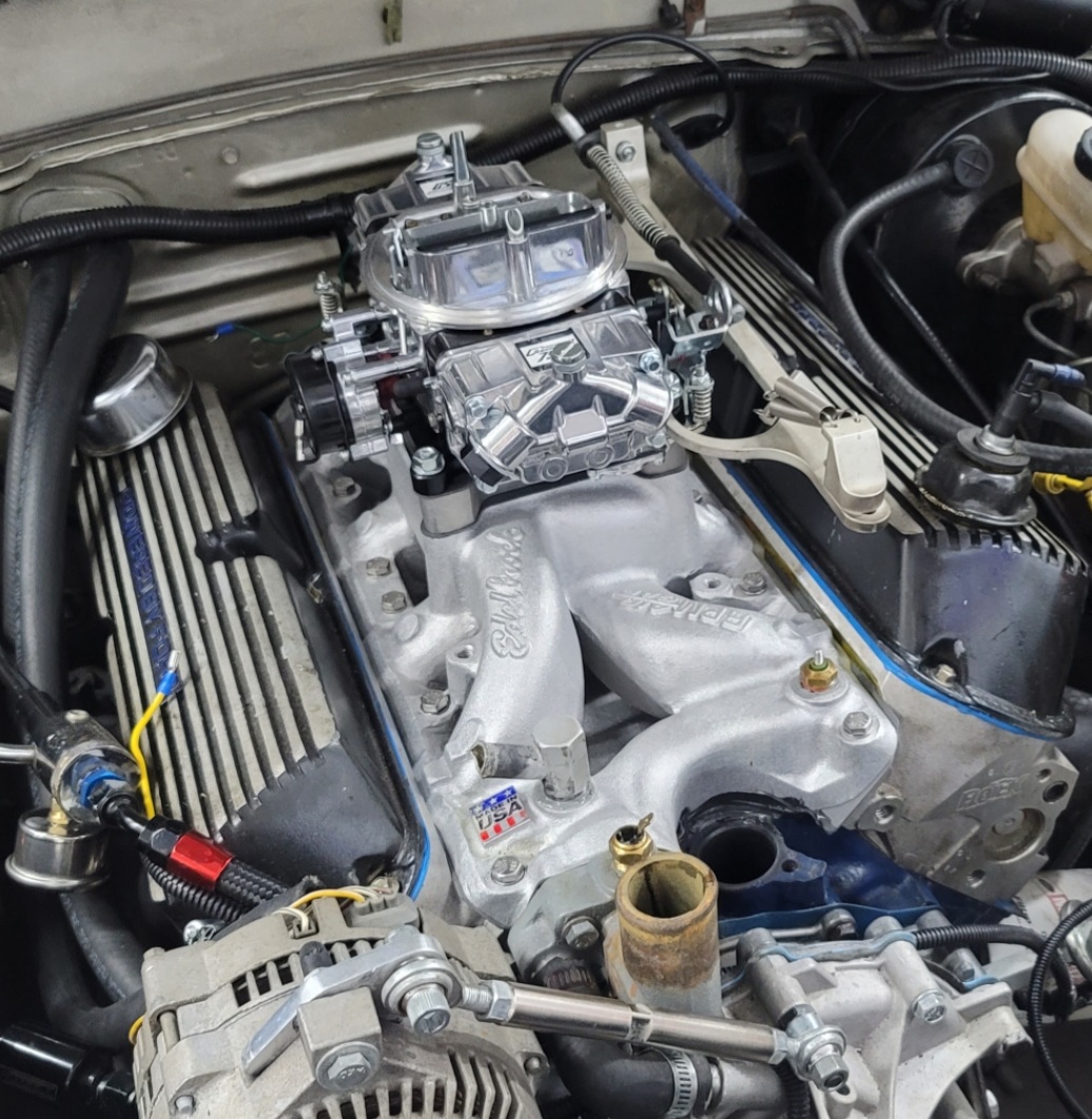

I managed to hook up the reverse lights. And do some more tuning on the carb. For the most part, it's running pretty well but there was a rough spot when barely into the throttle. There is a transition fuel feed between the idle and primary circuits. That's where my problem was. I increased the idle feed restrictors 3 sizes and that cleared it up 90%. I can live with it for now. I'll go ahead and order another size or two bigger and install them the next time I have it apart.
While I was in there, I rejetted again... primary and secondaries. I'll really need to get in it to see how it does, but I don't have a good "test hit" area near me lol!

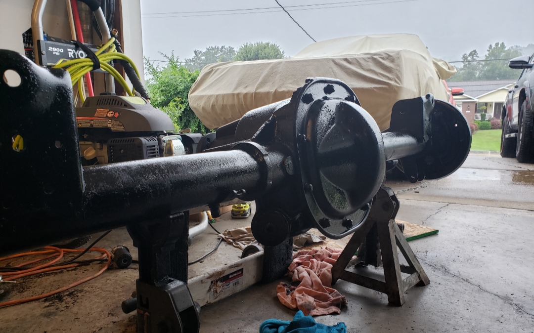

Did the final setup and assembly of the 8.8 today. I also started working on cleaning up the housing. That will probably take me a day or two. Lots of wire-wheeling, rust converter, then paint. I took a minute to weld a few spots on the axle tubes, just for good measure.

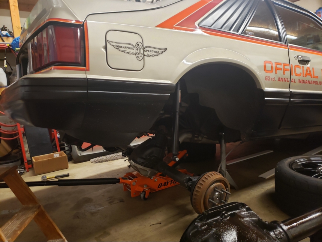

I managed to get the entire rear end housing cleaned up, coated in rust converter, painted, and installed new wheel cylinders and upper control arm bushings (the bushings that go in the housing itself). I also got the rear end dropped out of the pace car...at least, everything but the parking brake cables. Tomorrow, I'll start pulling the drum brakes apart and see if I can't get the new rear end installed and ready for cruise-in this Saturday.
Got the rear end installed today. Everything buttoned up, except for topping off with fluid. Rtv should be set up tomorrow and I can fill it.

I haven't updated this in a while, but I have done a few things to the car. I went to a dual plane intake (performer rpm air gap) and a 750 carb. I just got everything back together today, so I'm still tuning on it. I also welded in full-length subframe connectors, installed the afr gauge (permanent install this time), and replaced the carpet.
I've been busy working on the cobra and didn't get a chance to tune the new carb, so I slapped the old 650 Brawler back on to get the car back and forth to a couple cruise-ins.
