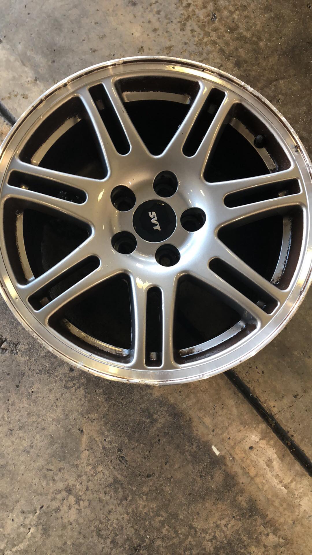

Picked up a set of wheels. I believe this makes the 3rd set I've picked up recently. I'm sure whatever I don't use will go to good use somewhere down the road.

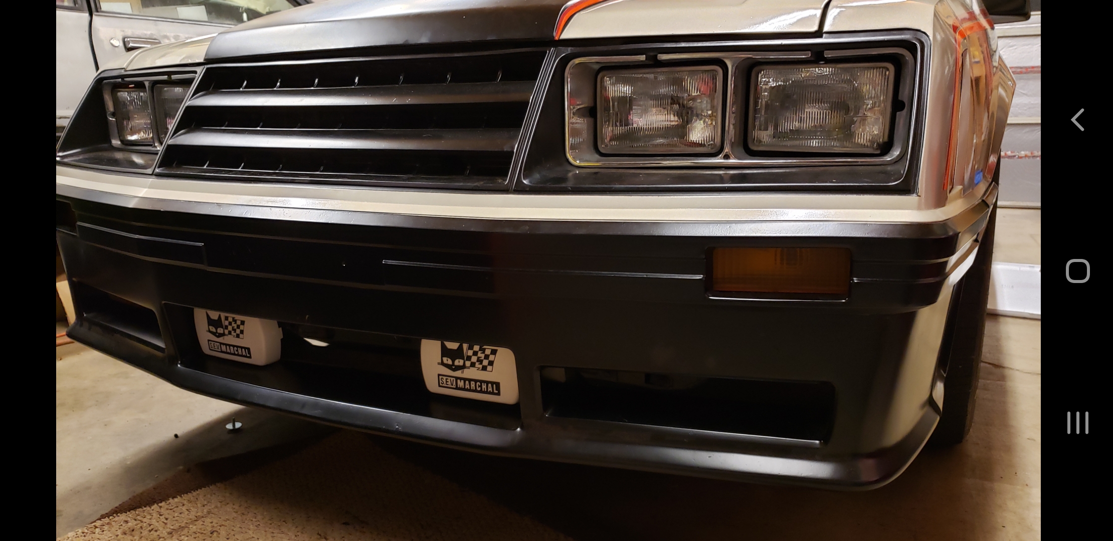

I had to go back to work for 8 or 9 days, but should be back in town just before July 4th. I plan on getting it aligned, mount the new wheels/tires on the car, and get the front lower air dam mounted. The air dam is proving to be a big pain, since I didn't realize I was missing a few important parts. Of course, they're not reproduced and are pretty rare pieces.. I've located all but 1 part so far.
If all else fails, would making the final part be too hard to do versus finding one?
Probably would be fairly simple, but time is the most valuable thing to me right now and having the right parts saves quite a bit. Anyway, I ordered the part today. One of the guys over at foureyedpride forum found it. Part# matched but no pic. We'll see when it shows up! It was a nos piece.
I have to admit... I'm not looking forward to the install. Doesn't look easy. I have to remove a reinforcement piece across the lower section of the upper/main bumper. It's held on with multiple small brackets with threaded studs. Can't see them, but by feeling them, I can tell they're rusted pretty good. I understand others have to just destroy them and then fab new ones. In fact, I'll probably have to fab or find substitutes for other small parts. The stuff i ordered is just the big parts.

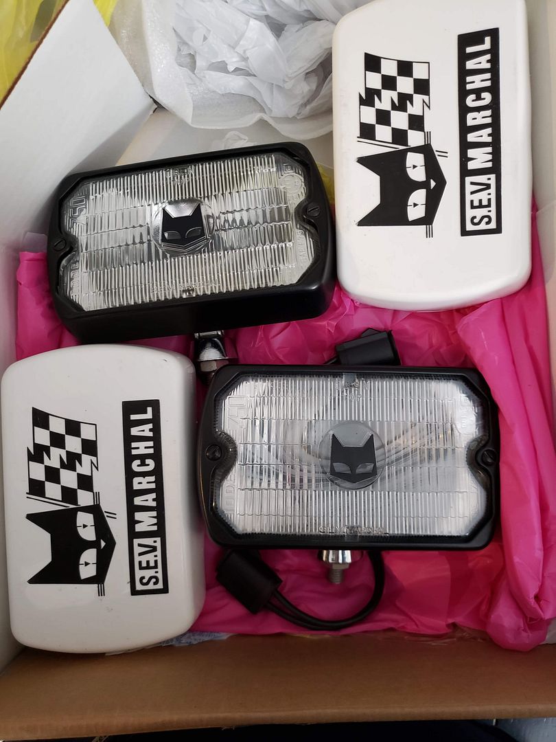

I got a few things done this weekend. Front air dam and fog lights installed, new wheels and tires on, more fine-tuning on the idle mix, tweaked the alignment (much better, but still need to get to the alignment shop when possible), and fixed a couple minor leaks. I took it out for about a 45 minute trip. Wiper motor crapped out, so I'm picking one up today. On my short trip, I discovered a few bugs that will need attention. Right rear brake intermittently drags. I'll need a helper to figure it out. Everything looks fine from a quick visual inspection. Fan still works intermittently. I'm going to try another fan controller. Reverse lights not working. Something occasionally rubbing in the rear. Probably a tire, but I can't quite pinpoint where. I will need to figure that out. No marks on tire or fender well. Dash lights also aren't working. I believe it's the dimmer/headlight switch.
