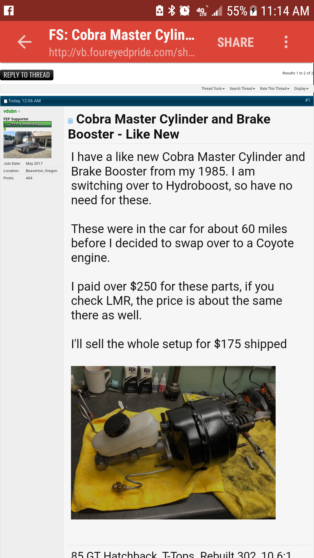

I noticed someone on the foureyedpride forum is selling a nearly new 93 cobra booster and mc.

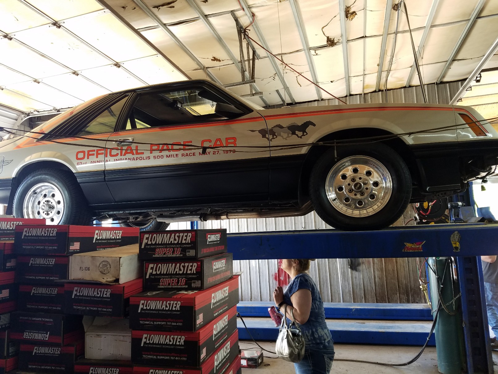

Man, I guess I've been too busy to keep this thread updated. Forgot to post about the exhaust. I had a shop install a pair of Thrush welded mufflers I had lying around with simple turn-downs. Didn't quiet it down much, but sounds 100% better.

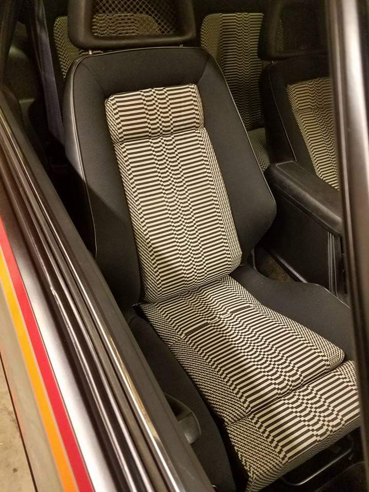

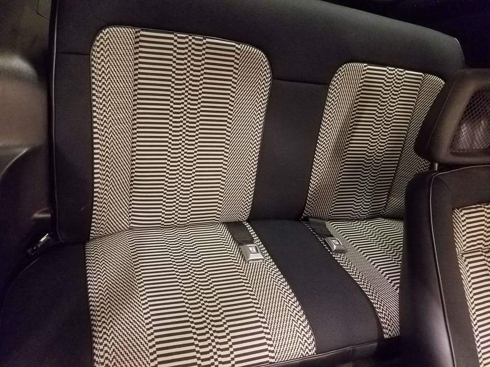

The seats look great.
