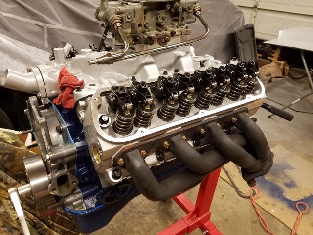

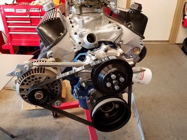

Here's a much needed update. I've been busy working on other projects, but finally got a chance to start finishing up the motor.
I'm cleaning up and painting the valve covers now, and that's not the carb I'm using on it. I just slapped it on top for pics. I've got more parts to go on, including the water pump (standard/clockwise rotation, which was a pain to figure out), solid motor mounts, MSD distributor, and a few other odds and ends. The intake, I had powder coated at a local shop. It turned out nice, but in retrospect, I wish I would have gone with a slightly darker grey color. No big deal, though. It's nice and I won't have to worry about the raw cast aluminum getting stained from grease and fuel.
I'll try and take a couple more pics once I get the valve covers on. I have a clutch, transmission mount, crossmember, t5 cluster shaft retainer (billet steel), and a few other items on order, so I may actually get the motor and transmission bolted in soon.

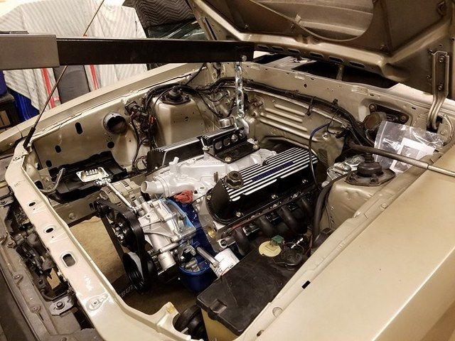

I have the motor bolted into place, but having a little clearance issues with the header hitting the steering shaft. It may be ok now, but I'll need to get the transmission in and see how the placement ends up. If the transmission bolted up keeps the rear of the motor high enough, clearance won't be an issue. If it wants to drop the rear of the motor down further, then I'll have to figure something out. I picked up another set of headers yesterday, so that might fix it if clearance is still a problem. I'll know this evening when I put the t5 in. I have some running to do. Going to try and pick up some Weld dradlites from a guy, but he's not being very cooperative.
Oh, and I picked up a new clutch cable for this thing. I just found out that the 4 cyl cable isn't long enough. The v8 is a little longer and has a bracket like the later model fox bodies that keeps it pulled over and attached to the inner frame rail.

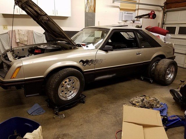

Got a little more done on the pace car tonight.
Picked up a decent used set of draglites. Front tires are good. Rears are dry rotted, so I'll need to get a set.

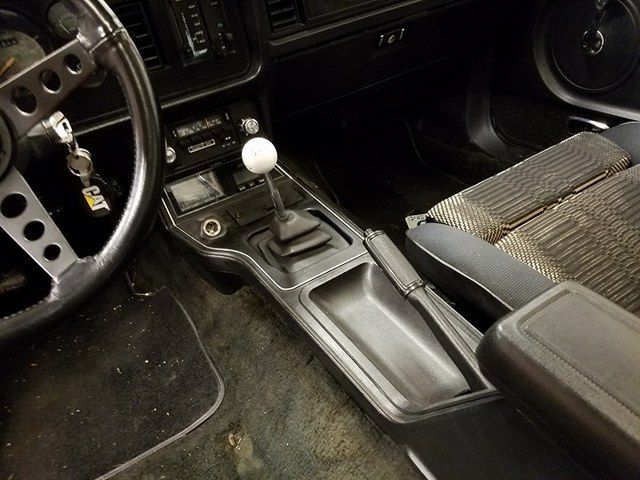

Got the new clutch cable in, along with the shifter and console.

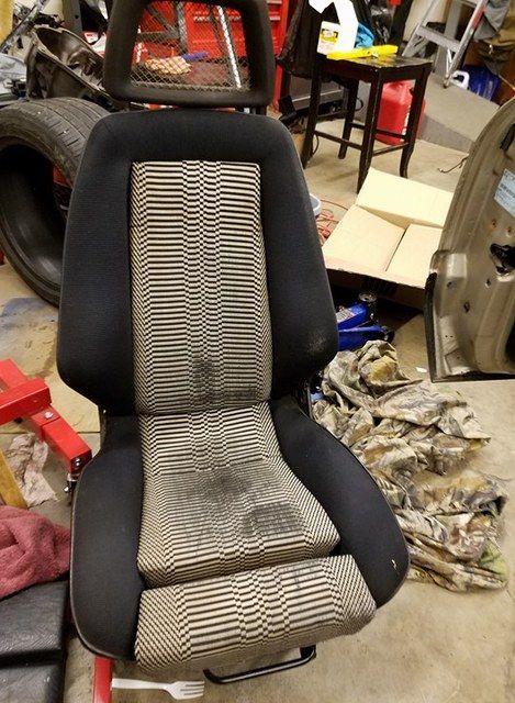

I had the driver's seat out so I could get to the clutch cable, so I think I'll run it by the upholstery shop today and see what they would charge to replace the zig-zag fabric in the center.

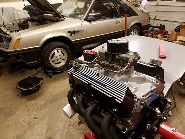

Well, a buddy stopped by and helped me get some stuff done. We mounted the msd 6al, the fuel regulator, carb, throttle bracket, and a few other odds and ends. We also tinkered a little on the 79 cobra.
Still a lot of work to do, but she's coming along.

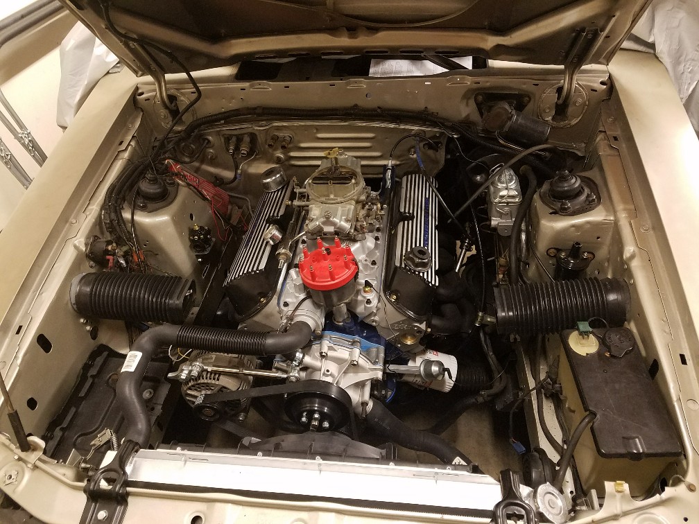

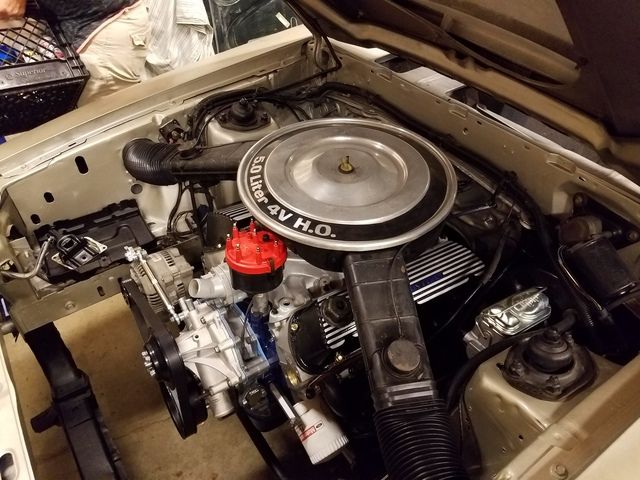

Got the motor fired up! Started right up. Had trouble setting timing and I figured out a couple issues with the distributor and plug wires. Had a couple fuel leaks around the carburetor, so I got those straightened out along with an oil leak around a valve cover. Not positive, but I think there's still a small oil leak somewhere down there. My neighbor stopped by and helped figure out the rest of the timing issue. With just a quick tune of the holley carb, we got everything working pretty well. Once I get her on the road, I can fine-tune it.
Other bugs I'll have to line out:
No power to starter relay trigger wire
Coolant temp gauge no worky
Fan controller no worky
Rear hard brake line leaking
Need lower thermostat
Need some mufflers
Here's a quick video of the first start-up. I need to get another video, since I got the timing and firing order straightened out.
I fixed a couple brake lines but couldn't bleed the front calipers due to frozen bleeder screws (which I absolutely destroyed). So I bit the bullet and ordered and installed all new front brake components, including calibers, rotors, hoses, bearings. After bleeding the system twice, I believe I still have some air in it. The rear shoes also need adjusted, but I ran out of time.
I ended up replacing the distributor since the gear was wearing. I got a steel gear but ended up breaking another roll pin on the distributor while pressing it on. (New one worked out fine and I already repaired the other one for future use)
I got the coolant temp gauge working (tied into wrong wire).
I had to replace the non-working fan controller... twice. The second one would only kick on by tapping on it. Same issue with the 3rd one. I replaced and tested the relays (ok) and checked all the wiring. I'm sort of at a loss on that one, but I'll come back to it.
The car starts and runs fine, even with needing the carb and timing tuned properly. In fact, I was able to take it for a quick spin down the road!
