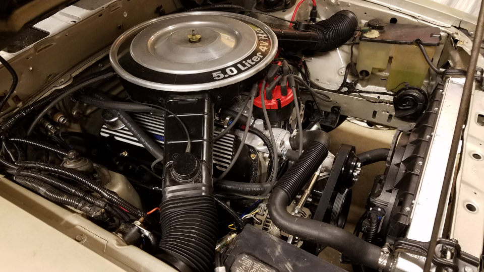

Ordered me a new fan controller. I'm tired of messing with these. I ordered a non-adjustable controller. Set to kick on at 185 and off at 165. You can order different switches for it, I believe, in case it ever needs adjusted. The controllers I'm having issues with are the Hayden adjustable units. I'm using one on my 88gt with no issues, but can't get a good one for the pace car.

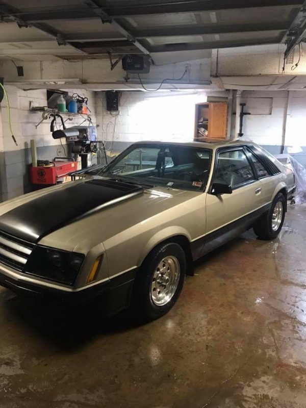

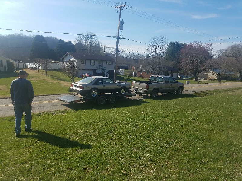

Made arrangements to have the pace car towed down to the painter's house tomorrow! I can address the small issues after paint. The wife and younger (21) boy got her ready to go today. They also pulled the recaro seats out. May send them to the upholstery shop before she gets out of paint!
Here she is loaded up and on her way.

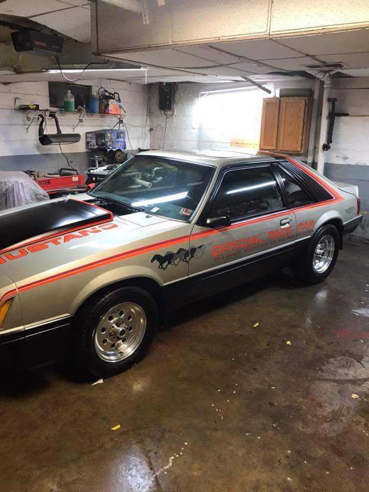

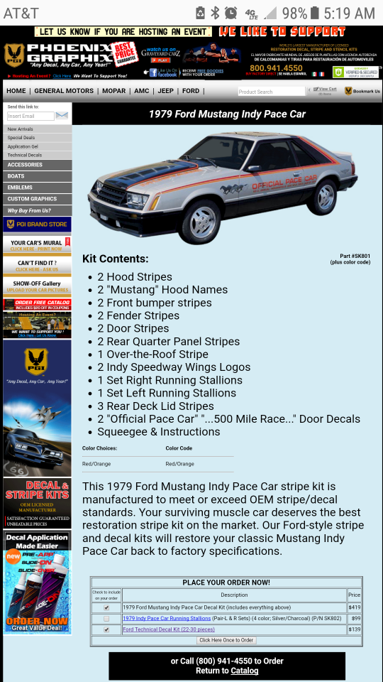

I ordered new side body moulding (Should be delivered today) and this decal kit.

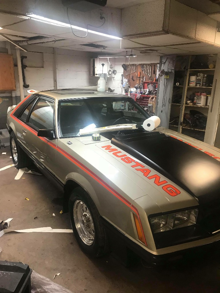

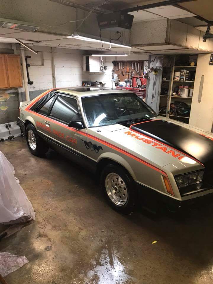

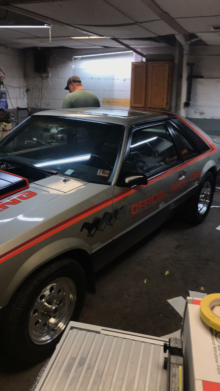

All of the stripes you see on the pace cars were decals and are included in the kit, with the exception of (oddly enough) the small pinstripe on the body side moulding. They were painted for some reason, but I believe I'll see if I can just buy some pinstripe tape that's close enough.

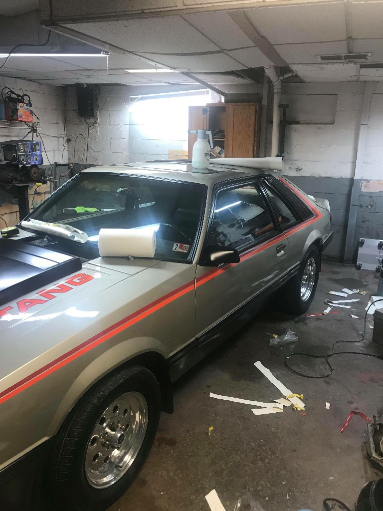

Oh, but I think he's going to apply all the decals for me. It's not exactly his specialty, but he is a phenomenal window tinter, so I'm sure he would do a great job. In fact, he'll be tinting the pace car after paint.
My buddy got her painted. He's going to start putting on the side moulding and decals in the next couple days. I won't be home from work for another 8 days, so the suspense is killing me. Can't wait to see it in person.
I was off the boat for about a week before getting called back out. In the short amount of time I was home, I fought with the cooling system and brakes. The new fan controller simply didn't work. Three Hayden controllers later, and I gave up and ordered a different brand/type. Long story short, I ended up swapping intakes to get it installed. The intake (a knock-off Victor) had some fitment issues, so it was quite an ordeal. Happy to say that it's finally back together, running decent, and has a working cooling system.
